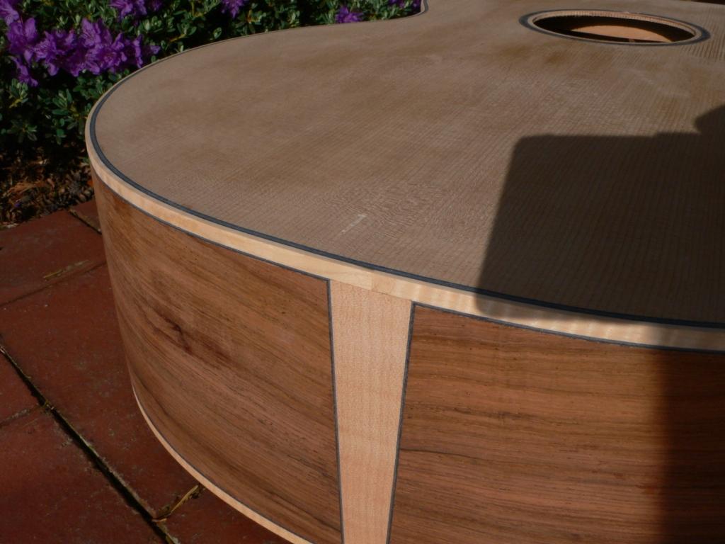

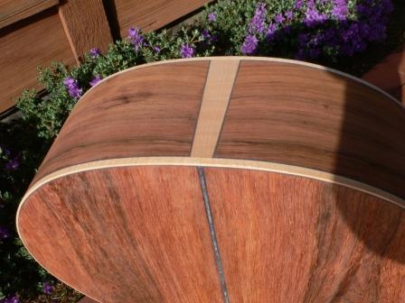

The binding size I used was .080" thick by .200" tall. I chose this based on images of guitars I'd found on the internet that I liked, both in proportion and general "artistry"?
Here are a couple of photos of the just completed binding job
As far as what size to rout the ledges, I pretty much used the trial and error method on scrap. It takes a little more time and can be frustrating, but makes the gluing much easier.
